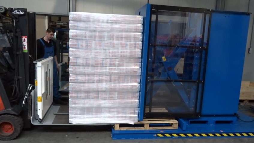

The Stationary Pallet Changer (SPC) of Meijer Handling Solutions simplifies this process and offers an affordable means of doing so. The SPC transfers unit loads from one load carrier to another. It can be placed within a receiving area where inbound goods can quickly be transferred to captive pallets, (typically plastic or aluminum pallets), and the wooden pallets can then be isolated from the rest of the facility. For outbound shipments, the process is reversed. Unlike a pallet inverter, the Stationary Pallet Changer does not invert the goods. This means products such as liquids, meat, poultry, powders, etc..., are easily transferred without risk of spillage. The Stationary Pallet Changer can be used in combination with slip-sheet attachments like ROLLERFORKS®, Push-Pull equipment or our unique ROLLERFORKS® Push/Pull.

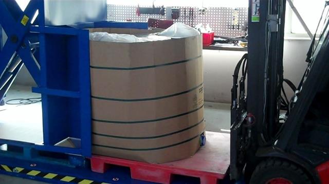

SPC met Octabin
SPC met Octabin
Even an octabin, ("combo"), filled with liquid is quickly and easily transferred from one pallet to another by using the Stationary Pallet Changer, (SPC). Octabins are often used by meat and poultry processers where wooden pallets are prohibited in clean-room areas. In this case, the combo filled with 1000 l/ 264 gal. of liquid is transferred from a wooden pallet to a plastic pallet in just a few seconds. Of course the Stationary Pallet Changer can also be used to transfer other types of unit loads as well.
