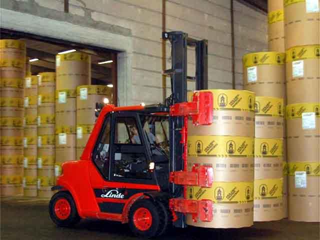

Excessive clamping force is one of the most common causes for paper roll out-of-roundness damage. The varying paper grades, roll weight and diameter, roll wrapper friction, clamp's contact pad friction, environmental and dynamic factors could make the clamping force control overwhelming for the lift truck operator. Hallsta Paper Mill solved this problem by using Bolzoni Auramo intelligent clamps.

The varying paper quality, roll weight and diameter increased the need to change clamping force during the loading of Holmen products. To solve this problem they decided to invest in 3 pcs 8,3 tons Bolzoni-Auramo Intelligent Multiple Paper Roll clamps CTX-generation 3, model CTX LA-830-6E.
With the investment in intelligent paper roll clamps life has become significantly easier for the paper handling in Holmen Papers own terminal.

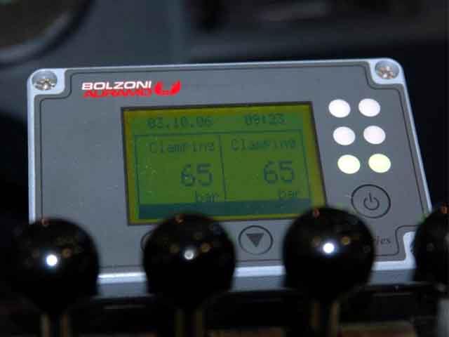

Bolzoni Auramo CTX is a fully automatic clamping force control system for paper roll clamps. It uses optimized, lowest possible clamping force for all situations and paper grades. The system minimizes the possibility of paper roll out-of-roundness.
CTX control uses proven technical solutions combined with advanced electronics for controlling and optimizing the paper roll clamp operations. The lift truck operator does not need to pre-select any operation parameters or change the clamping force settings when handling the loads.
From the handling point of view the intelligent clamp operates the same way as any conventional clamp. The lift truck operator has full control of the arm opening and closing functions.
All Bolzoni Auramo CTX clamps share the following operational principles: total clamping force control, minimized clamping force in all handling situations, fast automatic clamping force control also in dynamic situations, full handling control regardless of the roll position, fully computerized control, integrated clamp operation testing and modular design.
