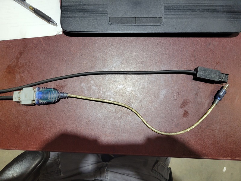

dilshanrandeep@gmail.com
I did post pics but has not been approved...
Thank you!

Thank you very much for keeping update forum
If you can please attach cable photos in this thread
Got it connected!

4.1.0.14 I cant find the interface part numbers but is oe cat to serial/usb cable, works with Diagnozer and supposed to work with TT but so far I haven't got it to work.
