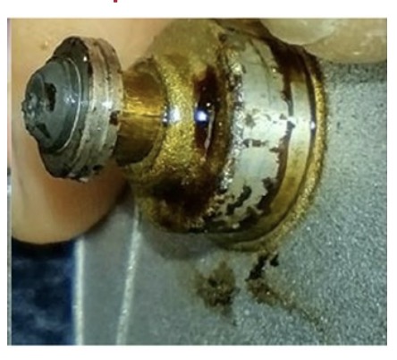

UKMHA warns of sticking valve
UK Material Handling Association is warning against excessive cranking over of the engine and repeated starting attempts for LPG forklifts.
This follows recent reports of cold starting issues on LPG trucks in Britain.
David Goss, UKMHA technical director, explains: “Investigations into the root cause are ongoing, but some instances have been identified where there is a build-up of deposits in the evaporator (pressure regulator), flow regulator or shut-off valve.
“The concern is that sticking valves could lead to a mixture which is too rich and therefore cannot be ignited. If there are then repeated starting attempts, this can lead to a release of a high unburned concentration of LPG which, in extreme cases, could present a risk of fire.
