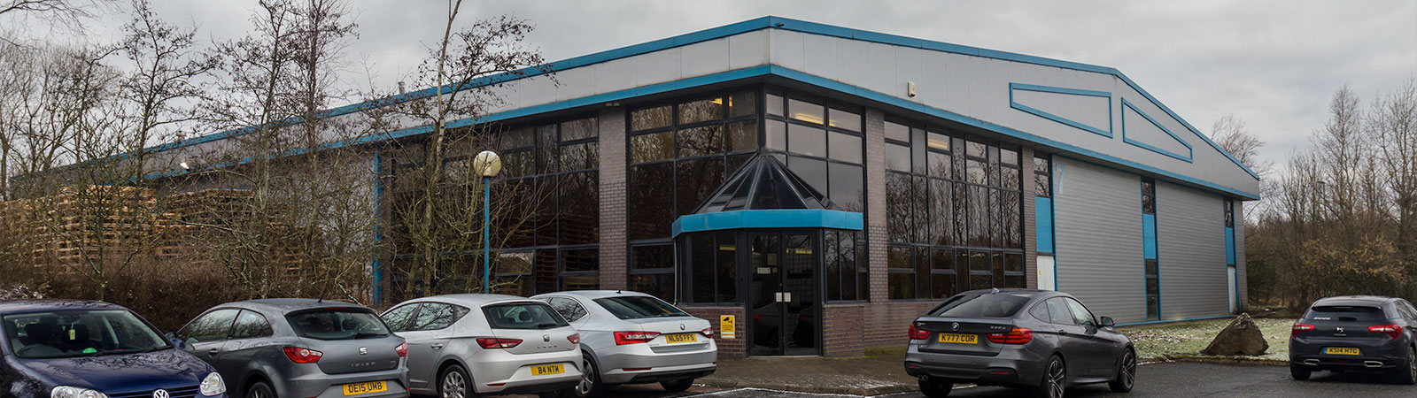

Corespec pleaded guilty
A cardboard manufacturer has been sentenced after a visiting lorry driver suffered life changing injuries when he was struck by a forklift.
Peterlee Magistrates’ Court heard that on 27 August 2019, the driver was assisting in the loading of pallets of cardboard tubes onto his vehicle at a delivery yard in Stanley, County Durham. In the course of loading the second pallet, the forklift being used to lift the pallets reversed and struck the driver, causing crush injuries to his right leg.
An investigation by the Health and Safety Executive (HSE) into the incident found that Corespec Limited failed to organise the delivery yard at the premises in such a way that pedestrians and vehicles could work in a safe manner. This was because of a lack of suitable segregation between pedestrians and vehicles.
Corespec pleaded guilty to breaching Regulation 17(1) of the Workplace (Health, Safety and Welfare) Regulations 1992. The company was fined GBP117,585 (USD160,000) and ordered to pay costs.
