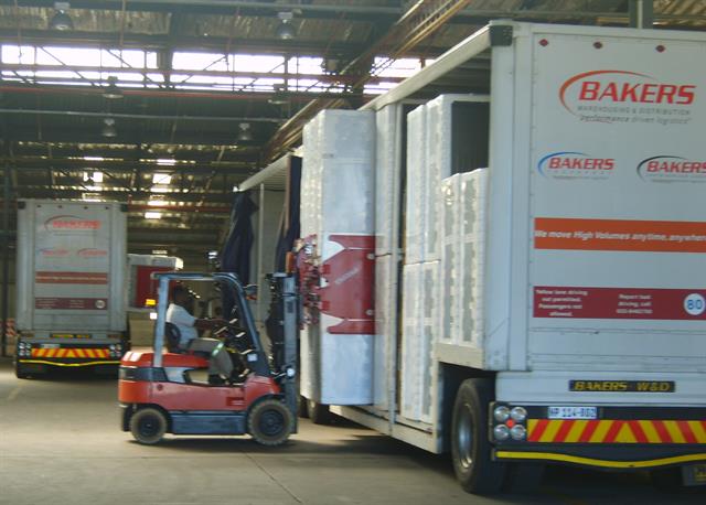

Forklift attachment manufacturer Bolzoni Auramo strengthen their fleet of Intelligent Home Appliance Clamps working at Bakers S.A. Ltd., South Africa.
Bakers SA Limited, private transport and logistics services company, offers a comprehensive infrastructure including distribution of high-volume, industrial and packaging products as well as containerised cargo and warehousing services. Bakers S.A. Limited is the Warehouse and Distribution center for Whirlpool South Africa (Pty) Ltd.
Bolzoni Auramo will soon deliver four KS14 C6A i-MOVE Intelligent Home Appliance Clamps. Mounted on 2,5 ton forklift trucks, the clamps will be used to handle different versions of freezers, chest freezers, ovens and cooking boards, unloaded from trucks arriving from manufacturing plant and transported to the warehouse before being loaded on trucks for delivery throughout South Africa.
