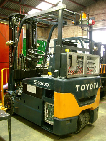

A Toyota forklift flame-proofed by Chess Engineering.

Sydney flame-proofer Chess Engineering Pty Ltd has modified electric forklifts for hazardous areas for 25 years. Chess's flame-proofing consultant Mike Robbins said there had been significant increase in trade in the last year.

Chess offered 10 protection techniques for 1.8 tonne to three tonne diesel forklifts.
Robbins said the most popular technique involved power limiting and, due to space constraints, it was important to maintain original control switches rather than the more bulky flame-proof switches.
Another Chess technique included fitting a stainless steel, water-cooled exhaust manifold in the engine. That prevented gases exiting the cylinder head from igniting in a hazardous area atmosphere.
