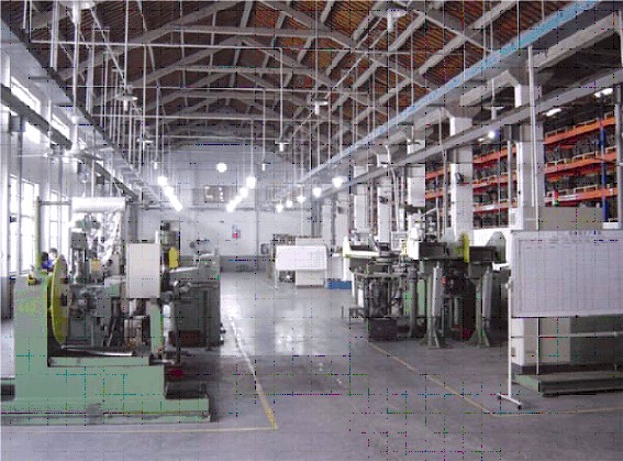

Renold Hangzhou's leaf chain assembly line.

Describing the Chinese plant's modern production and testing equipment, Robertson says the facility includes fully automated spectrograph for analysing incoming material; high-speed presses; Japanese-designed mesh belt furnaces with fully automated zone controls; German high-speed automatic assembly lines with integrated riveting, camera recognition system, tight joint check, proof loading, oil and reel; and "the most modern chain test house in China" that has "the only specifically designed leaf chain wear test rig in China".
