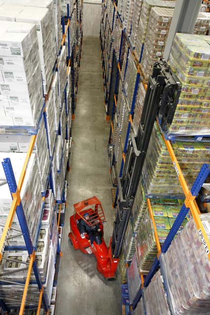

Natco considered guided VNA Turret trucks for its Buckingham site, but rejected these because they would have impeded the low-level order picking tasks. Man-up Combi trucks were also rejected as too dangerous - again because of the risks to workers below.
Instead, Natco chose a fleet of five Flexi G4 HiMAX articulated VNA trucks from Narrow Aisle Ltd. The Flexi's design enables it to load like a counterbalanced machine - outside the aisles - but it can also work in very narrow aisles.
This dual-purpose functionality guarantees the user a wide range of benefits - not the least of which is the ability to load and unload lorries, then deliver pallets directly from goods-in to the pallet racking in a single operation, according to Flexi.
Online, meanwhile, opted for the Hi-Lift articulated forklift range produced by Redditch-based Translift Bendi. It installed a B318 three-wheeler model which can comfortably work in 1.6 metre wide aisles and will lift 800 kg to 9 metres. Online's maximum pallet load is 600 kg but pallet sizes vary widely, including double width pallets.
Apart from the inherent safety advantages of the truck's design, including better load vision, lack of rear-end swing, hill start and safe load rotation, the Bendi comes with safety features such as reversing bleeper and flashing light, according to the company.
"We can get twice as many pallets in our warehouse now," says Jotham. "We would have lost hundreds of bays if we had chosen a counterbalanced or reach truck instead of a Bendi."
