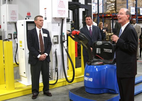

From left: Bruce Luff of Air Products, Scott Kliever of Sysco Houston and Andy Marsh of Plug Power at a hydrogen fuel cell demonstration.
