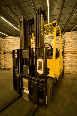

Rush Tracking Systems has sold 50 of its VisiblEdge radio-frequency-identification (RFID) forklift truck packages for deployment in five unique and different situations. Rush has invested more than USD350,000 in developing VisiblEdge.
"We have deployed on Yale and Hyster trucks" and can deploy on any forklift, says Chuck Thompson, vice president of sales and marketing.

Now, a truck-mounted load backrest with RFID hardware can be moved between forklifts.
With Rush input, Cascade Corp of Fairview, Oregon created standard part numbers for bolt-on and screw-down load backrest hardware suitable across the forklift industry. Cascade manufactures forklift attachments, forks and accessories.
Regular VisiblEdge-specified forklift components on the load backrest include two cargo antennas, an industrial grade RFID reader, a rugged rack tag antenna, a floor tag antenna and a cargo presence lift sensor. The vehicle-mounted terminal is located separately for operator viewing. A trained user can install a load backrest on a forklift in about four hours and, as needed, remove the fully equipped backrest in about two hours for use perhaps on another rented or owned forklift. A move involves disconnecting and reconnecting wires to the power source, terminal, reader and antennas.
