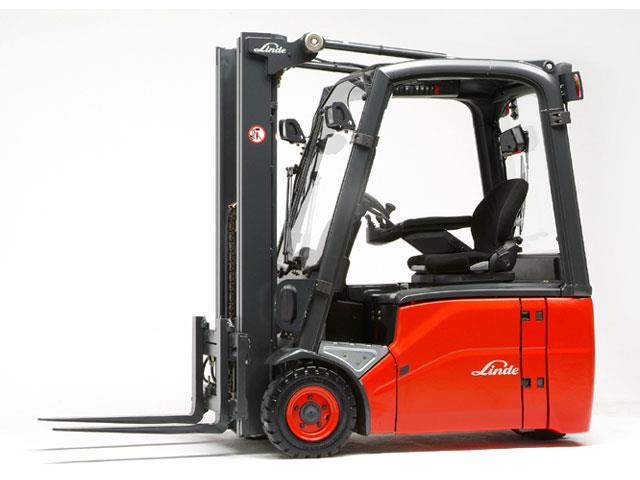

Manfred Höhn, Linde Material Handling GmbH & Co KG marketing service manager, said the German company had kicked off a new marketing label for its forklifts at the Bauma trade show in Munich last week.
"Our answer to current environmental and health issues is Linde PureMotion."
He said Linde PureMotion was an umbrella term covering Linde's design principles and other solutions that reduced energy consumption, lowered emissions and enhanced eco-friendliness.
Linde introduced the E12-E20 electric forklift range in 2006, claiming it was setting benchmarks for energy efficiency.
The electric forklift range, based on Linde's electric counterbalanced 39X series and R14X to R17X reach trucks, was the first forklift for the European market to have an on-board battery charger. Linde's engineers spent 3-1/2 years developing technical innovations in the drive and control units to produce energy savings.
Höhn said Linde created an E-Indicator, the value of which was the load throughput time multiplied by the forklift's energy consumption.
"This is the first efficiency index for the materials handling industry. In a lorry working cycle, Linde's E-Indicator value [for the E12-E20 range] is ahead of the competition."

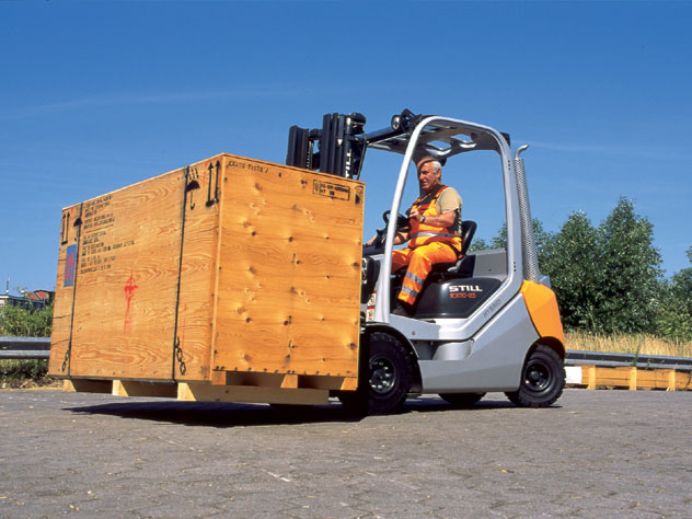

Hamburg, Germany-based Still Company made environmental and driver protection the centrepiece of its Bauma presentation.
Still's hybrid RX70 forklift
Still says its RX70 diesel truck, introduced in October 2006, is the first in the world to be equipped with a hybrid drive. It consumes 2.5 litres per hour and emits 6.4kg of carbon dioxide for each hour of operation. (According to a transport emission model developed by a German research institute in 1999, an average passengar car travelling at 50km/h emits 9.9kg of carbon dioxide per hour.) Still claims the RX70 is the most economical forklift of its class; the less fuel it consumes, the less carbon dioxide it emits.
Still senior vice president Bert Frisch said:
"Our products and company traditionally have a very high green factor. We are happy to have the world's best diesel truck in carbon dioxide emissions."
The RX70's hybrid drive unit has a diesel gas engine that drives the generator to produce electricity that in turn feeds the electric traction motor. A hydraulic variable displacement pump that feeds hydraulic oil into the hoist and steering system, only when needed, contributes to fuel savings.
