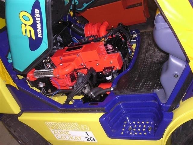

A standard forklift converted into an EX truck by Pyroban.
EX forklifts are constructed from the ground up or converted from standard forklifts. Pyroban, a leading European EX systems provider, converts about 600 forklifts a year to a recognised EX standard. The company is the exclusive or an approved EX conversion supplier to forklift manufacturers like Toyota, Jungheinrich, Hyster and BT for conversions in accordance with European standards and directives.
Malcolm Davis, Pyroban's sales & marketing director in the UK, said it typically took four weeks to 12 weeks to convert a standard forklift to an EX truck.
"It depends on the size and specification of the truck. The process involves establishing the parameters of the truck you're converting, manufacturing materials, installing materials, testing the truck and benchmarking against the product and getting certification," he said.
