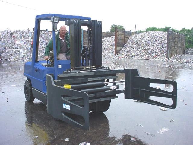

Kaup's general purpose bale clamp.

Kaup claims its range of recycling bale clamps is the most highly developed in the world for handling baled recycled paper and general handling tasks in recycling plants and paper mills.
"A new bale clamp with a smooth, outer arm design has been introduced for easy entry between bale stacks without damage to neighbouring bales. Our standard sideshift system is independent of the clamping cylinders. The sideshift function is performed by specific sideshift cylinders," Killmann said.
"One advantage of this system is that we are able to fit a pressure regulation valve into the opening circuit of the arms. Opening of the arms usually happens with the piston head side, which means you have at least three times the force when operating a clamp compared to closing it.
"We have learned from monitoring our competitor's products that quite often bolts break or arms are damaged due to the typical opening and closing movement of the arms when drivers try to enter the bale stacks," he said.
