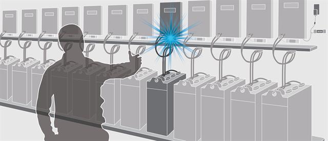

Rotation
The #1 cause of reduced battery run time, reduced battery life and waste is improper battery rotation. Left to their own devices, operators will take the closest battery (in order to make the quickest change) or the newest battery (in hopes of getting the longest run-time). This is despite the fact that the correct battery - the battery that has had the longest cool down time since charging - may be in the back of the battery room.
iBOS ensures proper rotation.
The key to ensuring proper rotation is to make picking the right battery simple. When proper battery rotation practices are implemented the results are dramatic. In a study of one company's introduction of good rotation practices the average battery run time increased from 6 hours 30 minutes to 6 hours 57 minutes - nearly half an hour.
Battery organizing systems are the most effective tool for ensuring proper battery rotation. The Philadelphia Scientific iBOS® (intelligent battery organizing system) monitors all batteries in a pool and eliminates operator error by determining which battery has had the longest cooling time since charging.
iBOS animated demonstration
Once charged, each battery is placed in a queue. The simple display tells the operator which battery to take and an alarm sounds if the wrong one is taken. In addition, the battery room manager can monitor all the essential battery room information online.

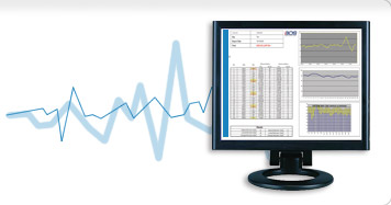

Rightsizing via the Internet
When combined with the power and accessibility of the Internet, battery organizing systems are the ideal tool for rightsizing battery fleets. For example, users of iBOS can subscribe to the iBOSWorld™ Web Service, which enables managers to optimize assets by analyzing performance and creating reports remotely.
Battery Room Reports via the Internet

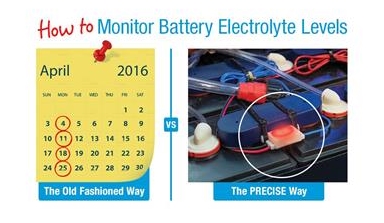

Battery watering
Watering industrial batteries has been called "a simple job done poorly," there are only two steps in the process: Determining which batteries need watering and watering them.
But each of these steps is fraught with potential pitfalls. In many warehouses, batteries are watered on a set weekly schedule. Not only can this be a complicated procedure, but also a time waster, as many of the batteries that are checked don't need watering - and many that are checked needed watering earlier.
Old Fashioned vs Precise Battery Watering
Using technology to determine the schedule
The most effective way to determine when batteries need watering is with a battery watering monitor. Monitors, such as the Philadelphia Scientific Blinky, allow watering on an as-needed basis instead of an unreliable schedule.
