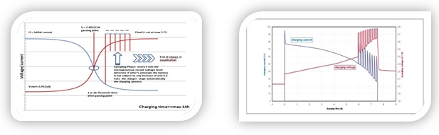

From its years of experience working with various OEM partners, Atib Elettronica has developed an increasingly complex and flexible electronic board involving high level functions like:
  • derivative dV/dt control
  • Capacitive termination (Charging Factor% and CFmin)
  • Pulsing technology
Left: Derivative dV/dt control Right: Pulsing technology

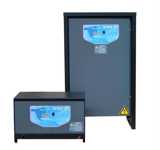

Intella Liftparts range of UL/CSA chargers will consist of 3 main types:

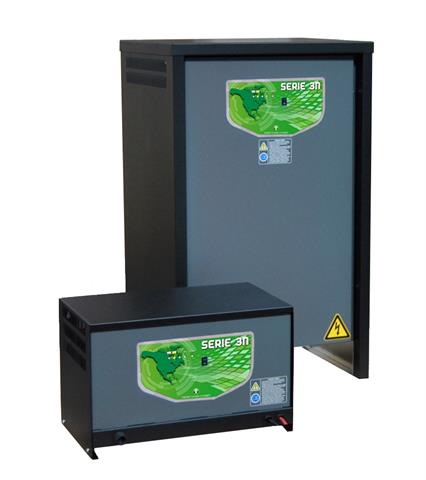

SERIES 3N ADVANCED
Wa charging profile - 8-13 recharge time - single-shift operation.
Visualization of charging phases by LEDs. Programming and diagnostic by external keypad.
Input voltages available: Single Phase 120Vac ± 5% 60Hz / 208-240Vac ± 5% 60Hz -
Three phase 208-240-480 ± 5% 60Hz / 600Vac ± 5%

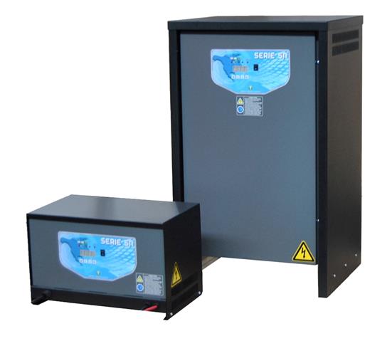

Series 5N advanced chargers
SERIES 5N ADVANCED
Wa display interface 8-13 recharge time - single-shift operation
Visualization of charging phases by LEDs and integrated display that give access to full diagnostic and programming.
Input voltages available: Single Phase 120Vac ± 5% 60Hz / 208-240Vac ± 5% 60Hz - Three phase 208-240-480 ± 5% 60Hz / 600Vac ± 5%
