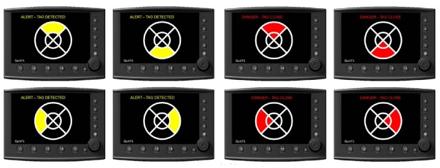

NearGuard's radar-like screen warns operators when an RFID tag is within range. At left: tag detected, four quadrants. At right: tag too close, four quadrants.

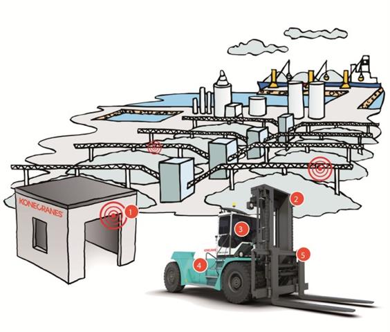

In short the NearGuard system utilises Radio Frequency Identification (RFID) technology to prevent collisions with obstacles or personnel. The NearGuard system consists of a minimum of two sensors that are mounted on the lift truck, one at each end of the lift truck, and RFID tags. The tags can be attached to a wide variety of customer-defined subjects including work clothing worn by employees, other items of mobile operating equipment, or stationery obstacles. Once a tag is located, NearGuard activates a radar-like control panel
(1)Radio Frequency Identification (RFID) tags constantly sending out a radio signal. (2)Directional RFID antenna (receiver). (3)Control Panel with display and audio alarm. (4)Connector box (5)Safety switch that activates the NearGuard system.
in the cab (shown below), that gives operators a clear visual indication of the direction and proximity of any RFID tag within range of the machine. Also an inbuilt audio alarm feature adds further safety by alerting the operator. The system automatically engages at a range of 50 metres.
In the field the NearGuard system makes operation safer especially on sites where trucks frequently pass under conveyors or when driving in and out of warehouses. The system allows operators to focus on the job knowing that the NearGuard system will assist them if needed, by alerting them in time to avoid possible collisions. This allows operators to do their jobs with less stress, greater efficiency and safety.
