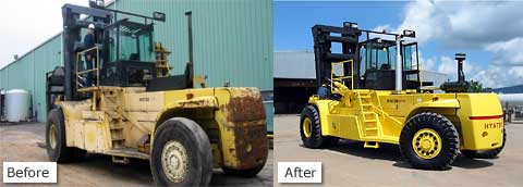

Hyster H970 Image courtesy of American Lift and Equipment
Refurbished machines are not just used machines; they have had major work on engines and bodies and should come with a certification for all work done. It is recommended buyers have an independent inspection conducted on any forklift being considered for purchase. The first thing to consider when purchasing a refurbished forklift is the machine's history: where has it worked, what were the working conditions? Check whether the machine has a serial or model number, this will indicate whether it is branded equipment and give some indication of the origin of its parts. Check the forklift's hours and inspect all its parts to ascertain whether they are in good working order and are genuine. The cost of a refurbishment depends on its scope, the machine's age, the price of replacement parts and labour costs.

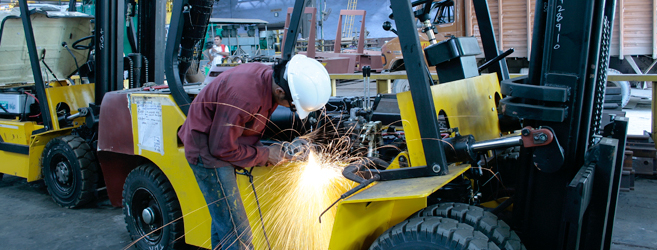

Fiorella I. Navarro Honores, of Spanish company Atica Servicios, believes the high cost of labour is the most prohibitive component in refurbishments. Suitably qualified technicians are scarce. Honores complains there is a lack of theoretical and practical training for forklift technicians in some parts of Europe. Lee Hamre, of Hamre equipment, California, whose company deals in forklifts of 50,000T. and above, believes there is a similar trade skill problem in the US and says it is very difficult to find good qualified technicians to work on large machines with computer controls. Carol Roberts, of American Industrial Transmission, says despite US trade schools offering more places, the number of graduating technicians has not increased and there will be continuing problems in the future. Those who are qualified are not 'average' forklift mechanics but highly trained technicians with electrical, computer, and mechanical skills and therefore more costly. In the USA, workshop fees can be $50-$65/hour.
Forklift undergoing refurbishment at Volta's workshop. Image courtesy of Volta Forklifts,India.

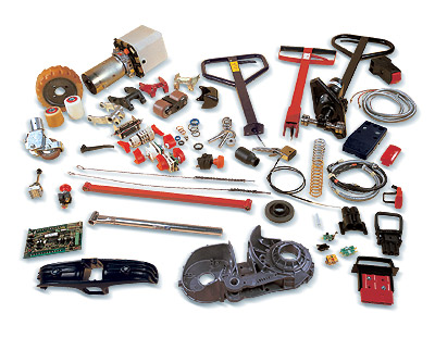

Parts
Parts image courtesy of TVH
Sourcing parts for forklift refurbishment appears controversial. Parts can come from the internet, OEMs or specialised used and new forklift parts suppliers. Your budget will determine your choice. Parts can be OEM - own equipment manufactured - or non-OEM, also known as non-genuine, aftermarket or will-fit parts.
Generally manufacturers and most dealers to whom Forkliftaction.com News spoke prefer OEM parts to be used when their equipment is refurbished. They argue OEM parts are better quality, last longer and come with a manufacturer's guarantee. Many forklift manufacturers have long lists of potential problems when using non-compliant parts and believe there is no guarantee non-OEM parts meet manufacturers' engineering specifications. Manufacturers argue that although the parts may come from the same supplier, non-OEM parts are often built with inferior materials. That is particularly evident in filters, brakes and computer circuit boards.
The reality is, refurbishers will use the cheapest or most readily available replacement parts. Even well-known forklift manufacturers source parts from third-party suppliers, called sub-assemblies, or remanufacture their own parts. Crown forklift part numbers often differ from their OEM part numbers because they use sub-assemblies from other major suppliers. Clark prides itself on its remanufactured parts used in refurbished Clark forklifts. The difference perhaps is that well-known manufacturers back their parts with warranties and a commitment to quality.
