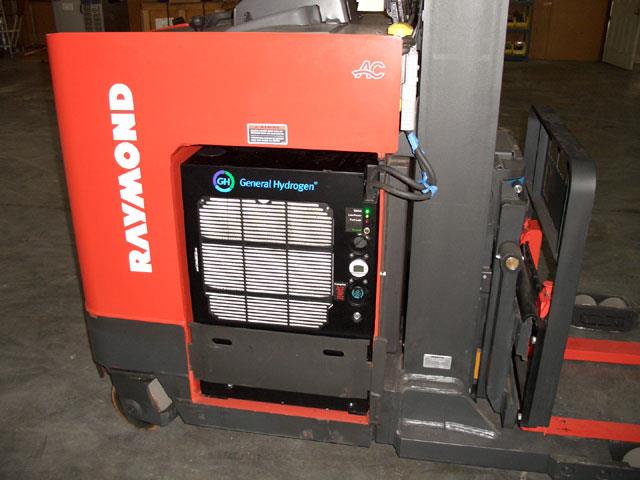

A fuel cell-powered Raymond forklift.
Raymond Corp is using its Greene, New York, plant as a test lab to observe what fuel-cell powered forklifts require to operate in a manufacturing environment.
