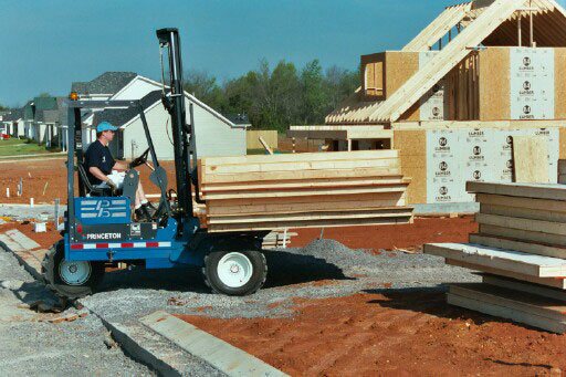

In North America, the world's biggest TMF market, the building materials industry has accelerated the TMF industry's growth. Bill Pohl, general manager of Ohio-based Princeton Delivery Systems, said the building industry was the US's predominant TMF user.
"In the early 1980s, distributors of building materials saw the machine on the road. They began to use TMFs to carry building materials," Pohl said. "Our customers in the building materials industry are lumberyards and brickyards. They have fleets of trucks and they put the TMF behind the trucks."
A Princeton forklift delivering pre-fabricated wall panels.
The billion-dollar building materials industry constituted 85 per cent of Princeton's forklift sales, 15 per cent were from agriculture and a "small proportion" from other industries and "miscellaneous business". Growth in the American housing industry had strengthened TMF sales, Pohl said.

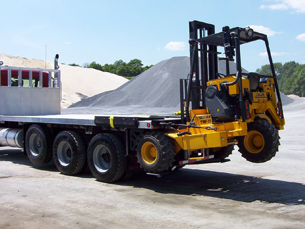

Sellick started making TMFs from Harrow, Ontario, in 1995. The TMF-55, Sellick's only model, has a maximum load capacity of 5,500lbs (2,495kg), a maximum lift height of 144 inches (3.66 metres), uses Kenhar forks and has a pantograph that extends the carriage to enable one-side lifting. The manufacturer plans to introduce a new model in 2007.
The advantage of a TMF is that truck drivers do not have to wait for help to unload a truck's contents. They merely disengage the forklift and use it to unload the cargo. Previously, workers at delivery sites manually unloaded trucks, consuming time and risking back injuries. Some trucks also carried or towed rough-terrain forklifts.

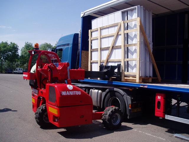

In 2005, the 10th year anniversary of Manitou BF SA's truck-mounted forklift, the Ancenis-based company renewed the entire Manitransit range. With that step, Manitou made a statement that it was in "a good position to be a strong player", Manitransit sales manager Olivier Traccucci said. "We are much more dynamic and efficient in sales [for the TMF market]."
A Manitou truck-mounted forklift loading glass onto a truck.
Manitou's forklift stands out because it is one of the few TMFs in the market with a boom instead of a moving mast. There are nine models in the Manitransit range, manufactured in Texas, USA, and Ancenis, France. The company's sales are split 50-50 between North America and Europe. Other global markets contribute to the European sales. Princeton and Moffett compete with Manitou in the European and North American markets.
Traccucci said the boom solved "the main problems" associated with traditional masted TMFs.
"With the boom, you don't have maintenance problems associated with using a mast, like problems with bearings and chains. The system of using reach forks to lift from one side is very expensive. If it's damaged, it costs a lot of money," he said.
Like a masted TMF, the Manitou TMF loses load capacity when the load centre is extended. A 2.5 ton Manitou TMF can lift 2.5 tons from the near side of a truck but 1.5 tons from the far side.
"With the boom system, if a pallet is too heavy to lift from the far side, the pallet can be dragged to the near side using the boom extension and tilting the forks,"Traccucci said.
Manitou started producing TMFs in 1995 after its traditional customers, TMF users, asked the manufacturer to add the product to its range. Manitou's main customers are the building materials, poultry and beverage industries.
For its 10th anniversary, the entire Manitransit range went through upgrades that included more powerful engines, longer booms for increased reach and lowered engine positions for better stability.

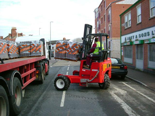

Moffett Engineering Ltd was founded by Cecil Moffett in 1945 to produce agricultural equipment in Monaghan, Ireland. In 1986 the company started making the Moffett Mounty truck-mounted forklift. After merging with Kooi in 2004, the TMFs are now marketed as Moffett.
Moffett marketing manager Tabe Bruinsma said Moffett had a 60 per cent market share worldwide. The Irish company produced about 4,000 TMFs annually from plants in Ireland and The Netherlands.
Early this year, Moffett introduced the patented Lift Assist system. Moffett boasts the system can clean lift more than two tonnes from the far side and avoids product damage caused by dragging product for lifting from the near side. One-side lifting is possible with a boom, like the Manitou range, or by using reach forks and scissors (pantograph). However, load capacity is reduced when lifting from the far side of a truck.
The Lift Assist system comprises two hydraulically-operated arms attached to the forklift frame. The arms make up for the shortfall between the machine weight and the load. They rest against the trailer, using its weight to support the forklift as it lifts loads from the far side of the truck.

Sellick forklift mounted at the back of a truck.
