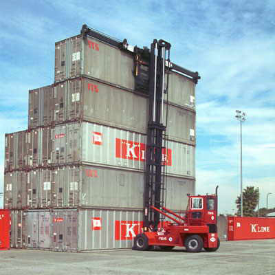

North America's container handling specialist
A Taylor empty container handler.
Taylor Machine Works Inc, of Louisville, Mississippi, and Hyster Company, of Greenville, North Carolina, are the only North American container handling equipment manufacturers. Taylor produces its machines in US while Hyster has moved big truck production to Europe.
Mike Boyles, Taylor's director of engineering, says a spreader is an "extremely important" part of a container handling machine.
"The unit is part of a system but since it engages the load, it's subject to a lot of dynamics - braking, accelerating, etc. The load can be raised quite high ... all these things put a lot of stress on the spreader. It's a particularly challenging thing to design.
"The vehicle is just as important. We view it as a system ... the whole design has to be balanced," Boyles said.
Taylor claims to be North America's largest manufacturer of laden container handlers. The family-owned company does not disclose its machine output or sales figures. It started making container handling equipment in the 1960s. A few years ago, Taylor established an agreement with Italy-based CVS Ferrari to market the entire range of CVS reach stackers under the Taylor name in US. However, Taylor made "a couple of models of reach stackers for specific markets in North America", Boyles said.

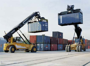

The European pioneer in China
Fantuzzi reach stackers at work.
Fantuzzi Group, of Reggio Emilia, Italy, the company that pioneered reach stacker and empty container handling forklift production in China, has made its own spreaders since 1968. The company, which claims to have a "prime market position" in the world's busiest container handling ports, Singapore and Hong Kong, is the only container handling equipment maker to produce spreaders in China. Dalian Forklifts and Heli are two of China's container handling equipment producers. None of them makes spreaders.
Fantuzzi product manager Jimmy Lozada rates spreaders as "very high" in importance to container handling equipment.
"They are the cause of 90 per cent of equipment breakdowns as they are the most stressed structure of container handling equipment. End users usually have electric or hydraulic problems due to the vibration and shocks spreaders are subject to."
Fantuzzi will make about 360 units of container handling equipment this year, half of which are reach stackers and half are forklifts. The machines and spreaders are made in plants in Lentigione, Italy, and Xiamen, China.
Lozada said the two plants had the capacity to accommodate future growth.
"The company was building around 450 to 500 container handlers in 2002 and 2003 and the in-house capacity for higher throughput has been positively tested."
However, Fantuzzi sources 10 per cent of its spreaders from Elme.
