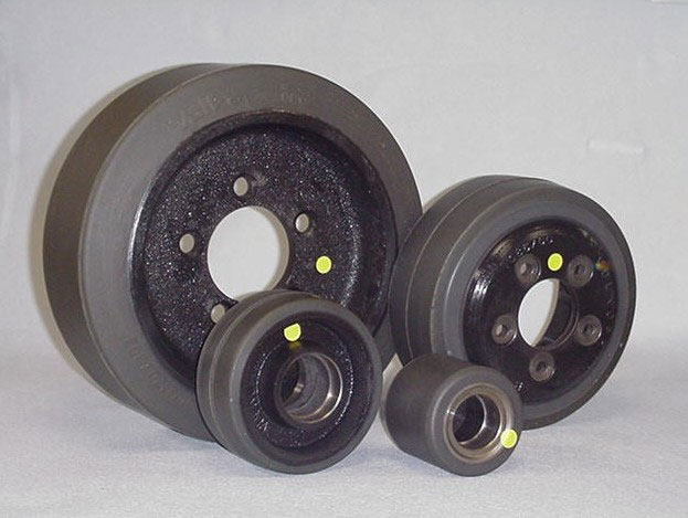

Sales and marketing manager Philippe Vindevogel told Forkliftaction.com News about 95 per cent of European OEMs used Vulkollan tyres and wheels for electric warehouse forklifts because other materials could not meet the forklifts' high specifications.
Vulkollan wheels are marked as electrically conductive by a yellow dot.
"Vulkollan has the highest load capacity and it's to do with specific mechanical properties of the material itself. It has three to four times higher load capacity than wheels with the same dimension in rubber and slightly higher than polyurethane.
"It is very heat resistant, its mechanical properties not changing much in a wide range (-35C to 85C) compared to -5C to 50C for rubber/polyurethane," he said. Its heat resistance has seen Vulkollan tyres used in roller coaster trains.
Vulkoprin makes press-on Vulkollan tyres (Vulkollan bonded onto steel rims) and Vulkollan wheels. The manufacturer is continually "redesigning the wheel" to optimise its performance for specific customer applications.
An example is Vulkollan electrically conductive wheels, introduced in 2005.
"It's not redesigned from zero but based on a standard. It can be used in areas at risk of fire and explosion from explosive or inflammable particles," Vindevogel said.
The Vulkollan electrically conductive wheel is non-marking and black, instead of orange-brown, the natural colour of Vulkollan. The black colour was the result of a "secret" additive to Vulkollan that made it electrically conductive, Vindevogel said. Anti-static wheels existed in the market but Vulkoprin was currently the only manufacturer producing electrically conductive Vulkollan wheels. (Editorial correction: Räder-Vogel of Hamburg, Germany, also produces electrically conductive Vulkollan wheels/ July 2006)
