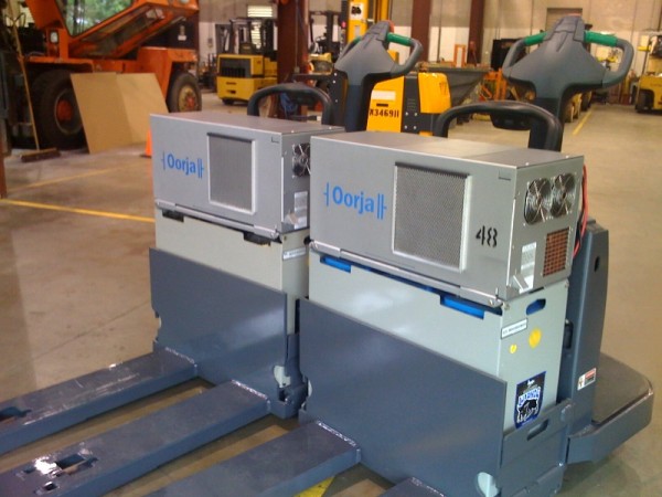

The OorjaPac is Oorja Protonics' on-board battery charger  that uses a methanol-based fuel cell system.
Sarah Johnson, Oorja Protonics' sales and business development manager, thinks that the future for battery power lies in fuel cells as on-board battery chargers "so downtime for battery change and for all charging is eliminated", resulting in improved productivity levels.
In 2007, Oorja Protonics launched the OorjaPac, an on-board battery charging system that uses a methanol-based fuel cell system. An OorjaPac continuously keeps a battery 30% to 80% charged without surge loading or the need to switch batteries. The system operates on direct liquid methanol fuel and emits clean water and minimal carbon dioxide. The Model H OorjaPac system can be refueled in less than a minute.
Oorja CEO Sanjiv Malhotra says the OorjaPac is more cost-efficient than hydrogen-based fuel cell systems as hydrogen systems require special fuelling equipment to handle pressurised hydrogen. The systems cost in the range of USD1 million. He says fuelling for alchohol-based fuel cells is safe and easy, using a simple tote dispensing system that costs less than USD10 million. The patent-protected OorjaPac can power Class 2-3 forklifts for two eight-hour shifts on five gallons (151l) of alcohol.
Last year, Super Store Industries Inc ordered over 35 OorjaPac systems for its Yale and Barrett walkie materials handling equipment in a freezer unit at the dairy product processor's California facility. The company's vice president of warehousing and transportation,Pete Blasquez, says the on-board battery charger impressed with its "productivity, safety and environmental benefits and cost savings".
Oorja currently supplies liquid fuel cells as on-board battery chargers to companies like Nissan North America, Unified Grocers, Super Store Industries, US Foodservice, Goldsen State Foods and Martin Brower. MHD Green Energy Solutions distributes Oorja's on-board charging system in North America.
