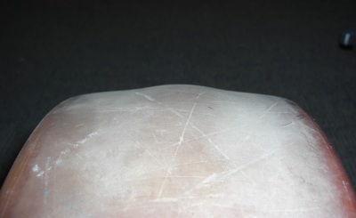

Typical damage: Axial displacement of the wheel tread while the wheels is externally intact.

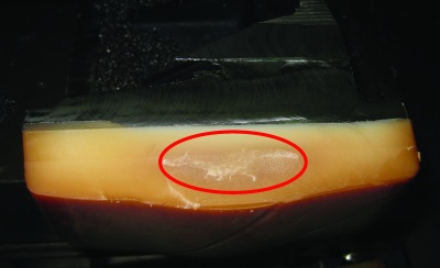

VULKOLLAN® wheel cross section: Because of flexing and the poor heat conductivity of <br />VULKOLLAN®, heat builds up within the wheel material. The material liquefies and then <br />crystallises again.
crystallises again.
In the above applications, flexing combined with the poor thermal conductivity of VULKOLLAN® causes heat build up within the wheel material, especially over long transport distances. Typical damage symptoms are axial displacements of the cylindrical wheel tread, while the wheels show no external damage. The material liquefies and then crystallises again. The consequence: The wheel must be replaced.

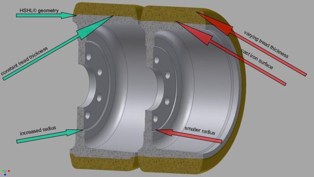

Comparison wheel with HSHL® geometry (left) and conventional wheel (right) - Click to enlarge
On conventional VULKOLLAN® wheels, tread thickness varies because of the draft angles of the cast iron wheel centres and core displacement. The cast iron surface is not machined.

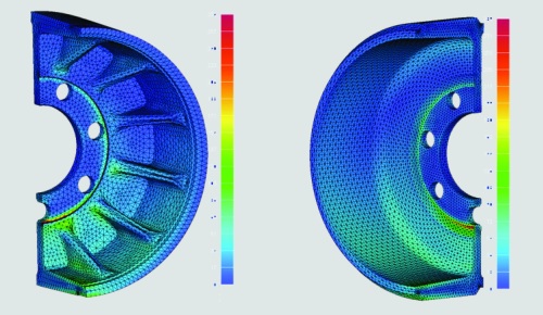

FEM analysis of wheel centre geometries - conventional version (left), HSHL® version (right)
With the RAEDER-VOGEL® HSHL® contour, uniform tread thickness is achieved through complete machining of the wheel centre. In the thermally critical area tread thickness is reduced. At the flanks, in the areas with the highest load and shear stress, adhesion is improved. Higher material thickness helps to avoid spontaneous tread separation. Together with the transmission manufacturers, we also redesign the wheel centres for greater strength. Mechanical machining and the contact surface are optimised.
Already at the first design stage, the parameters wheel tread thickness and wheel centre geometry are validated by FEM analysis. The new designs are also tested on the RAEDER-VOGEL® wheel and castor test rig.

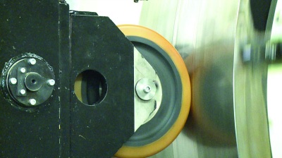

Destructive testing of a wheel on the RAEDER-VOGEL® drum test rig
The reduction of the wheel tread thickness does not increase surface pressure. Calculations as well as tests on our wheel test rig have proven that - for large radii - even at maximal load the surface pressure increases by max. 10 % and is far below 700 N/cm². Thus the wheels can be used on all standard industrial floors. Damping is hardly affected either - the indentation of the wheel is reduced by a max. 0.1 mm/0.004 in.

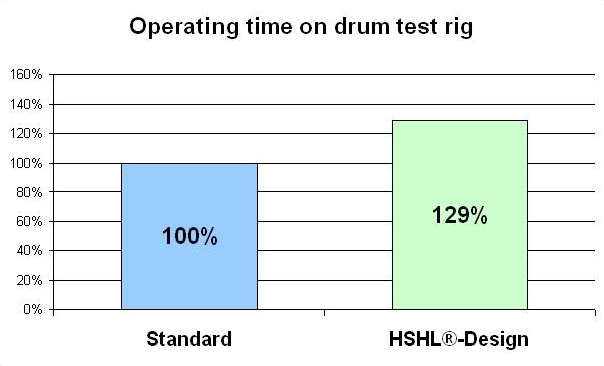

Destructive testing of HSHL® drive wheels for walkie trucks and order pickers on the drum test rig has shown that the service life of the wheels increases by 29 %.
Comparison of operating times until complete destruction of standard and HSHL® wheels
