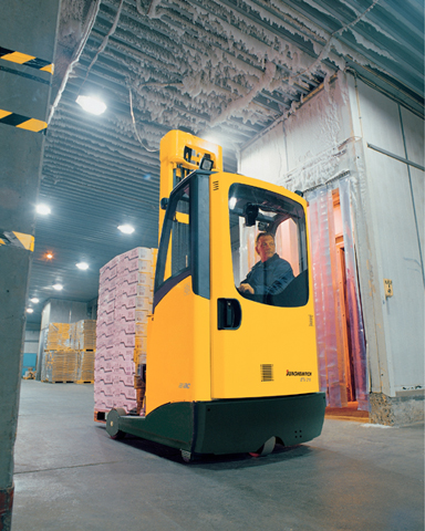

Jungheinrich ETV 216 working in a cold room.

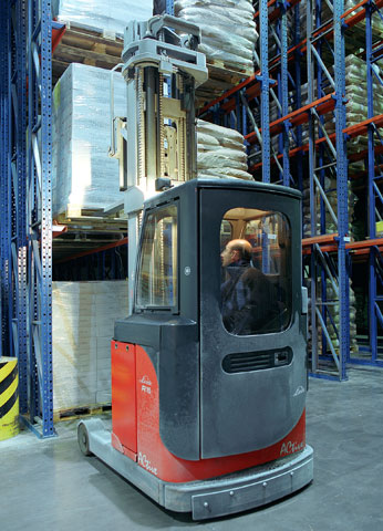

A Linde forklift at work in a cold environment.

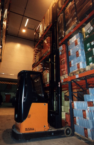

Still GmbH's Juergen Wrusch, in Hamburg, Germany, says the forklifts have heating plates and heating resistors distributed over the whole vehicle to keep the major components at service temperature.
A Still cold room option.
Electric heaters in forklifts use battery current but do not have a big impact on battery life. However, Wrusch says a battery's capacity decreases by approximately 1% for each degree Celcius the temperature drops. Its standard capacity is reached at a temperature of 30°C.
TMHE product marketing manager Anthony Nadalin says the battery life is shorter because the chemical reaction between the battery cell plates are affected by temperature.
Wrusch says the batteries' temperature must not go down to as low as -30°C. They must either be in operation or under charge.
"It is advisable to charge the batteries outside and to continue running the forklift in the cold room using an exchange battery.
If that's not possible and charging must take place inside the cold room, Wrusch advises using "a second energy source" for the forklift's heating system.

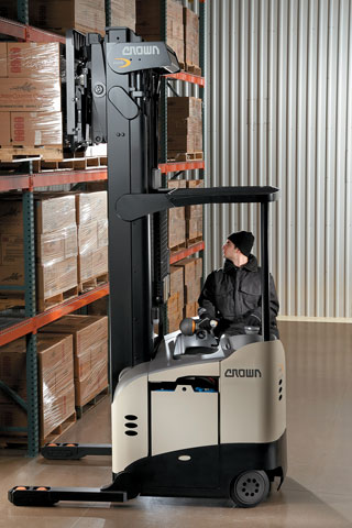

Crown forklift with newly launched ThermoAssist option.
Specific to the cold room forklifts with cabs is the two-way intercom system that allows the operator to communicate with the outside world. He or she is able to communicate without opening the cab door and can be alerted to external events like alarms.
Linde spokeswoman Heike Oder says the intercom system protects the driver by keeping him or her in the heated cab and also saves heating costs.
